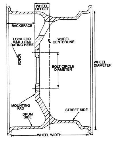

The only problem I hear is your wheels are sticking out more than you thought they would. Did you not plan for this when selecting your tires and rims? I have included a Rim diagram, a chart comparing various rims, and finally a pic of my X with 33x12.5 BFG AT Ko's mounted on 15x10 3.75BS rims. As such with 4" BS your tires will stick out about 3.5" more than the stock tire/wheel setup.
Anatomy of a Wheel Rim

how is it that 33x12.50 on 8 inch rim fit under arches with 3.75 backspacing?...I thought that with 4" backspacing there would only be approx 3/4 inch difference according to your diagram?
This is a pick of ExplorerDMB's Explorer with 15x8 3.75 BS. As you can see the tire doesn't fit completely within the wheel well. The same tire will stick out an additional 0.85" if mounted on a 15x10 4"BS wheel. One thing to consider (which many people don't realize) is that tire width depends on rim width.. A 33x12.50 tire will measure 11.6" if mounted on a 15x8 rim and 12.4" if mounted on a 15x10 rim. Besides look is there a problem with the tires sticking out too far?

Thanks for the info, I will look into it. Can we say that as I am using a 4" back space that the difference between my setup and 8" wheels with 3.75 backspacing is 3/4" ?
yep, thats it..and the fact that the wheels are 10 inchers.
why am I having so much trouble over 3/4 inch then :rolleyes:
ok...the backspacing has your wheels sitting in 1/4" more than with a 15X8 with 3.75 bs...but your wheels are 2" wider. Therefore, the wheel actually sticks out 1.75 inches more...right?
The difference is 3/4" (give or take due to slight variations in rim and tire fitment). The real issue is that you're going from stock to 15x10 and don't have a 15x8 rim for comparison. With only a stock rim/tire to compare the 15x10 is a huge difference.. If you could test fit a 15x8 rim & tire the upgrade to 15x10 wouldn't be as drastic.
No... if you look at the above tire diagaram the red line indicates the stock wheel stick out distance. The 15x8 3.75BS sticks out 2.8" more than stock while the 15x10 3.75 sticks out 3.8" more than stock... Therefore a 15x10 4BS will stick out 3.55" more than stock.. So the difference between a 15x8 3.75bs and a 15x10 4BS would be 3.55-2.8= 0.75"
