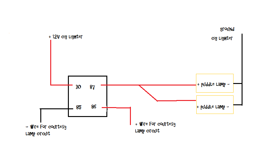

I'm thinking that if I use a relay I can solve my problem. I made this diagram to show how I "think" it should be wired up. Can someone weigh in here and tell me if this looks right or not? Do I need a fuse anywhere? maybe between the relay post 30 and positive wire of the cigarette lighter? Do the grounds look OK?
I'm sourcing power from the cigarette lighter (power port) in the center console because it is always hot and will need to be to power on the puddle lamps while the car is still off when I press the unlock button on the key fob.
Any help or advice is much appreciated so thank you in advance.
