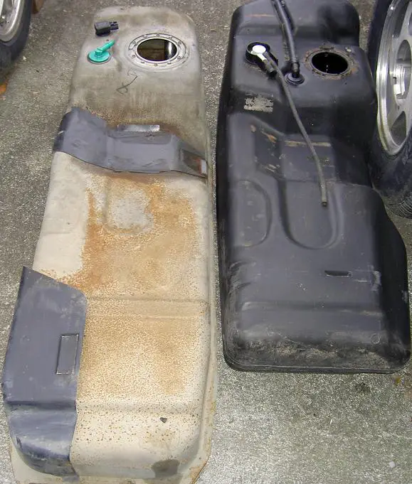

You can use a 95-01 skid plate, but it will have to be the Sport(2dr) models. The 1st gen's have a shorter gas tank, both versions, than the 2nd gen tanks. The later trucks have steel tanks, and they are slimmer and longer.
The 1st gen 4dr tank holds 22 gallons, and it's the same length as the 99-01 Sport tanks, 17 gallons or whatever they hold. I have my old 93 tank to try in my 98, with a 2000 Sport skid plate, it's a perfect match.
Below is one of my 98 4dr gas tanks, and my old 93 Limited(4dr) gas tank next to it.

Yes! The black plastic tank that you have looks nearly identical to the one in my 1994 Explorer. I believe you when you say that I do not need the skid plate, but what I am struggling with is how to make secure the tank without the skid plate (?).
