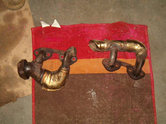

Mine was cracked. You couldn't see it with the heat shields on. It's very common.

The 96 5.0L has the earlier sheetmetal manifolds, not cast iron as used later. They could easily be cracked or rusted through. They aren't THAT hard to change through the wheelwells unless a few fasteners break and need to be extracted. That's probably what the shops are hedging against with the ridiculously high estimates.

Here's what you'll see under that heat shield-right off my son's 98 from New York.
I couldn't actually see the crack while it was mounted on the truck

Don't waste time or money trying to patch them.
Your mechanic knows what he's talking about-it's a very common problem.
