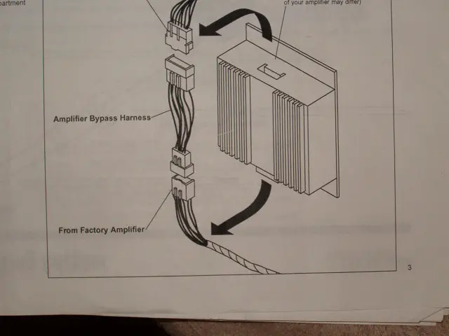

If her Explorer has a factory external amp (premium sound), you will need to get an integrator to integrate the factory amp with the new HU (expensive way) or get the amp bypass wiring harness (cheaper way and better way). The amp bypass harness is the one in the picture on the far left that has a connector on both ends. The factory external amp will be located in the cargo area, near the passenger-side wheelwell, behind the plastic panel.

Thanks a lot man, you guys really helped me out, I ordered a metra (70-5513) from crutchfield.com Quick question about the install.
It is just simple as plugging in the bypass? Do I need to run any additional wiring? The HU is already installed and is receiving power? This is all I need to do right? is it a 2 minute job?
The hardest part is getting to the factory amp. You have to remove the panel in the cargo area on the passenger side. Just above the wheel well you'll find the amp. Just disconnect the proper side from the amp, splice in the new harness, then remove the other connector from the amp, and connect with the new harness.
You can splice in the new harness using solderless connectors (crimp style) or you can solder them & use shrink tube.
It's gonna take more than 2 minutes, but should be less than an hour.
Good luck man!
The connectors on the ends of the bypass harness are different from one another and will only go one way. This is because the input side of the factory amp connector has the power wire to the amp but the output side only has the speaker-out wires. It IS as simple as disconnecting the two connectors from the amp and plugging the wiring bypass harness into them.
Like Ru Dawg said, though, the hardest part will be getting to it. In addition to the press-pins around the side window, you will have to pull back the carpet from the trim panel and remove three or four screws that go into the floorboard, remove the seat belt hanger (T-50 Torx bit), remove the two phillips screws from the rear side door scuff plate, and remove the floor scuff plate that goes across the back edge of the carpet. All of this should allow you to easily fold the panel back enough to easily access the amp. To completely remove the panel, you also will have to remove the coat hook above the rear passenger door and the passenger door scuff plate.

Whoops! My bad, I misread Gimp's post, thought I read the bypass was the one on the right, that's why I said to splice it in...
So once you get to it, it should only take 2 minutes to bypass it!

man if the image is how your supposed to do it im really mad... the stereo shop told me i had to bypass the amp with the bypass wire, and cut the other end off and use an aftermarket amp to power the speakers otherwise i wont get sound...
