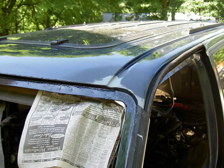

The cargo area glass can be sealed from the outside, if you don't mind a thin line of RTV visible. I've done it a few times, almost all of them will leak eventually. If you are fine with that, just run some cheap tape along the top edge of the cargo glass, outside. Tape off the seam where the glass rubber trim meets the body, leave the tape about 1/8" from the rubber, so 1/8" of paint shows. The tape on the rubber you can make it 1/4" or so from the paint seam. Spread a very thin layer of Ultra Black RTV between the tape, smoothly as you can. The leak is usually along the top or one of the top corners. So taping it off including the top corners is a good idea.
That works well and will last for many many years, but if the sight of a strip of RTV bothers you, yank the interior trim and pull the glass out. I've done this because it's very quick and works. I had removed four of the cargo glass before, rebuilding two Explorers. So I was familiar with the time and difficulty of R&Ring the quarter glass. It's not hard, but it's not fun either.

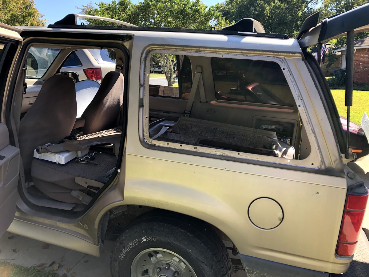

I don't know about your other issues exactly, but the 2 rear quarter glass require what is called "butyl tape" www.amazon.com/3M-Windo-Weld-Ribbon-Sealer-08610/dp/B00GA3TMEG
I recall 1 package being enough but 15' seems a little short.
The 1/4" thick butyl tape linked above can be a bit on the thin side. I used the 5/16" thick stuff. You can get it at a NAPA store also. Will run about $35 there, but they usually have it in stock. It comes in a roll of 15' which is enough to do one of the rear cargo windows, but not both. I did my driver side last year and I still have about 1/3 of the roll left (right at 6'). You'll need two rolls if doing both sides.
Getting the windows out to reseal isn't too bad. Hardest part is getting the inside side panels out and out of the way. Once that's done, the nuts holding the glass in come off easily and the window just pops out. Make sure you have an extra set of hands holding it place when removing the last few nuts!
