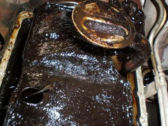

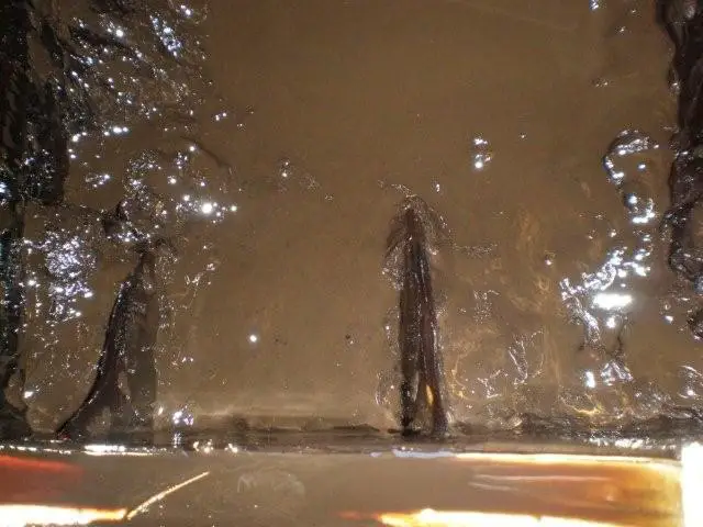

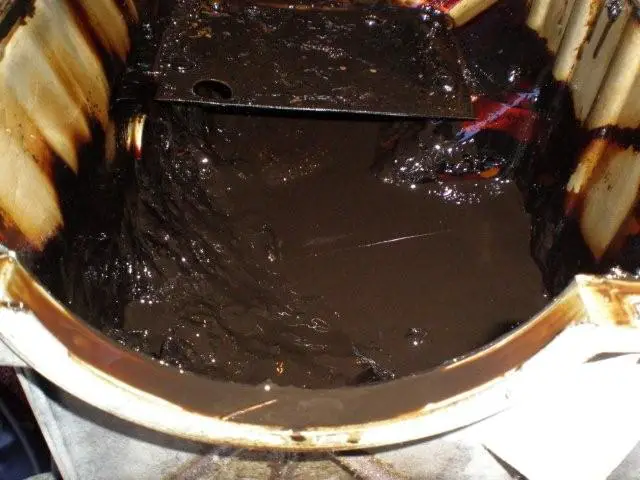

I just bought a 97 Explorer with 100K on it with zero oil pressure...
Dropped the pan and there was three inches of solid sludge..... So much the pick up screen was submerged which equals zero oil pressure.
I've read all over the net that this is a common problem with these 4.0's if they are run over 3K on oil changes. What are the thoughts on this forum?
Thanks
Very common...Especially high mileage engines...
When you don't know the maintenance history of the truck slude can build up massively...I bought a 99 Sport with 151k on the clock and the no oil pressure situation was there as well...
I dropped the pan and this was what I found...I cleaned the windage tray, the oil pan, and replaced the pump and pickup...Ran the truck for 20k with excellent oil pressure and still had lots of sludge in the top end even after running synthetic oil for the entire time...Finally replaced the long block and now the engine is sludge free and going to stay that way..
