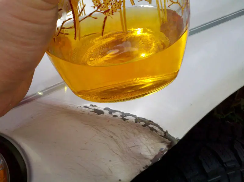

Today the engine was 100% back together again. With the fuel pump fuse (#3, 20A yellow) removed and the ingintion plug pack disconnected I cranked the engine many times to get the oil circulating and more importantly pressurising the Timing Chain Tensioners. Then after the fuel pump fuse was reinstalled and a plastic hose placed over the fuel rail test port, petrol and air were expelled each time the ignition was turned on as the fuel pump then runs for a few seconds.
Finally the big test. Will it start and run?
To my amazement it started instantly and ran as smooth as a baby's bottom. There were no rattles from the chains and the engine RPM soon settled down to a normal idle speed. The engine sounds fantastically quiet and performs beautifully on the road.
