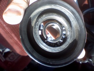

Explorers are much better at pulling that they are at pushing :) You have a 2nd year 2nd-gen, a very solid vehicle, especially with the 5.0 engine. Besides what's been mentioned here already, I have seen quite a few threads talk about the idler pulley and tensioner having bearings that grenade themselves sometime after 100,000 miles, eating the serpentine belt while doing so and leaving you stranded at the most inopportune times.
Hey man I got the same ex. My idler pulley blew out bearings around 120k miles. And I had a terrible exhaust manifold leak around 125k. But other than that is runs hard and fast for a 2ND gen explorer. If there any mod questions you need ask man don't hesitate. o and the rear axle gear is limited slip with 3.73 gears and it a ford 8.8 axle.
Awesome. Looks like if the belt is warn ill throw a new idler pulley on as well. Thanks!
