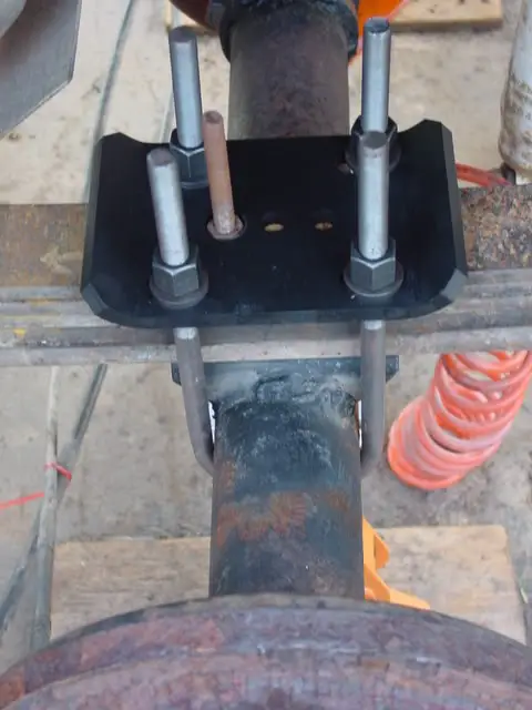

You can move the rear axle back ever so slightly by making a new set of perches and putting the center hole (that the leaf spring eye bolt goes through) forward a bit.

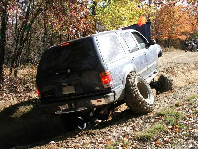

Pics below are of my Explorer stuffing a 36" Interco TSL-SX with the axle moved back (via the method above) about 3/4" of an inch. So I'm sure you'll be fine with 33"s cauz dont forget, the axle moves back as the leaf spring gets flatter ("stuffed").

holy sh*t!!
