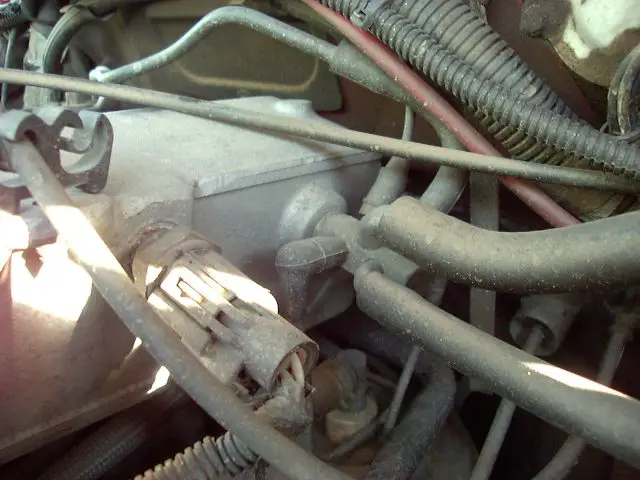

one

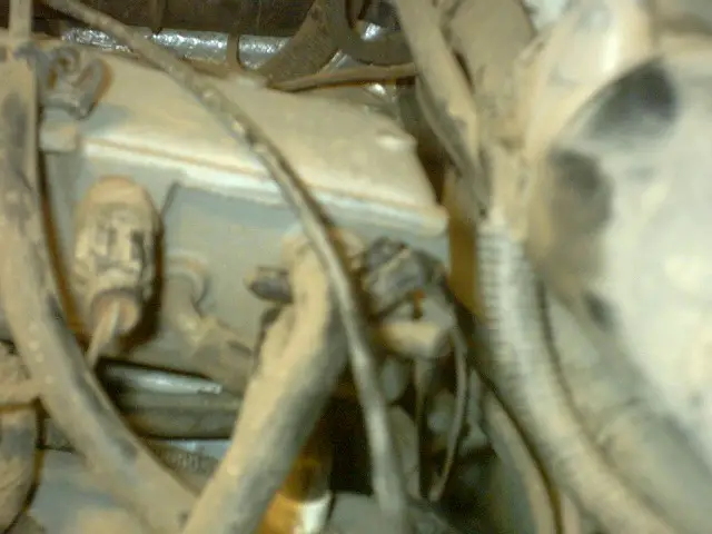

two
I didn't really count, but I think there is only 6 hoses
If this is where you are talking about I have 7 ports and 4 are hooked up to something and 3 are just capped off. Sorry about the bad pic but I need to wash it under there :( Mine is also different than blaine's so it might be closer to what a 94 might look like (I'm a 93)

Stoked! Thanks for the Pics guys!!!!! But the one I'm misssing, one of you have it plugged and the other has it connected. In the first pic its the plug pointing and the connector. I didn't get to check anything last night. I had to finish the pond install. Hopefully tonite and again thanks for the pics.
The pic Hvac posted would be closer to your X since the '91 doesn't have a EGR valve. If all else fails, cap off the open port and we'll look at it when you get to Moab.
