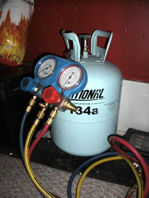

just guessing without the benefit of reading pressure gauges either too much or not enough refrigerant. It takes a certain amount of pressure to satisfy the low pressure side switch and too much will cause the high side pressure switch to disengage the clutch.
Just barrow a set of A/C gauges and note both sides during cycling and with engine off. I will admit at this point that I am not good at metric to SAE conversion.
The low pressure (in psi) should be about 1/2 the ambient temperature degrees (F), ie. 40psi on a 80deg F day.
The high side should be about 2-1/2 times ambient temp.
Static pressure (system off) should be slightly higher than equal to ambient temp on both high and low sides.
Good luck.
