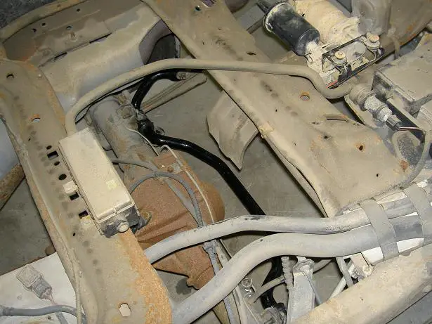

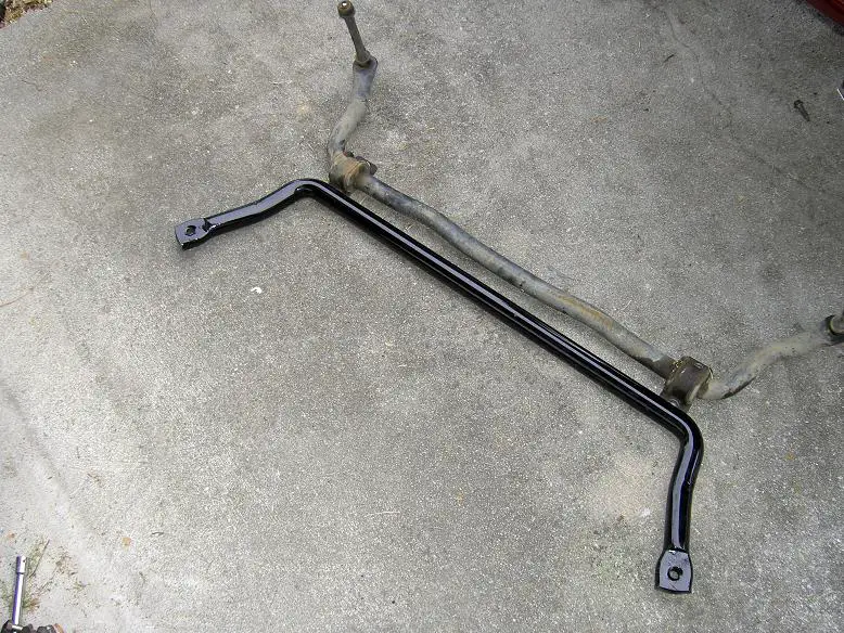

The 95-01's are likely all 34mm up front. Go with the ES bushings, black if you can, they have graphite in them and the red do not. Swap your rear bar, that one is tiny. Get the EE bar, it's well known for greatly improving handling. I have two, and a 1.5" front bar on one truck. Regards,

EE is the common name we use for Explorer Express, they have some nice and expensive suspension parts. Most parts stores carry ES bushings, they are the best. Regards,

My front bar is 1.5", or 38.1mm thick.
