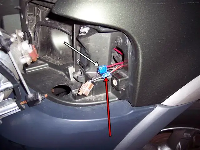

I tapped the parking lights at the driver's side parking light itself, not a big deal since you have to route wires in that area anyway. The picture is from my how to for installing signal mirrors, the link is in my signature. There is some good info there for routing the wires.
Peel back and remove a portion of the plastic wrap - The red arrow indicates the quick splice connector connected to the Green w/White Stripe wire for the signal mirror - The white arrow indicates the quick splice connector connected to the Brown wire for my fog light relay.
