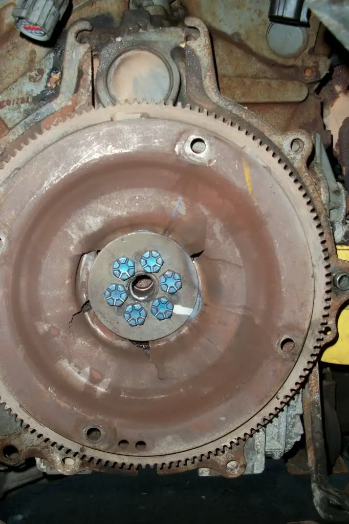

This is what I found when I removed it:

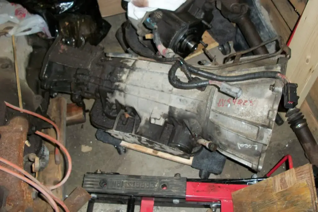

And the trans itself:

So now to decide what to do with it, beyond swap the flexplate and make sure the motor is solid. Probably looking to sell it after I find that out, but may put it back together, or part it out. If any of it is for sale, I will be getting elite status before posting here.
