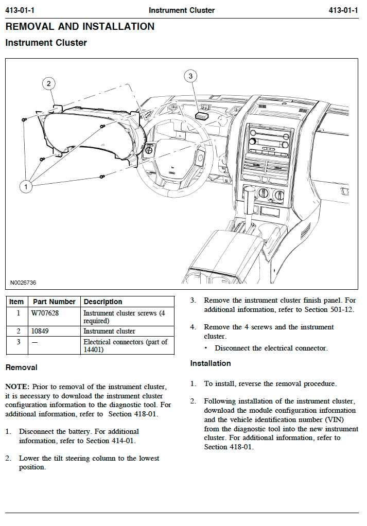

Service manual says:
  • Condition: All the chimes are inoperative
  • Possible Sources: Instrument cluster
  • Action: INSTALL a new instrument cluster.
REFER to Section 413-01.​
Good news is, you can snag one on Ebay for about $50.00. Bad news is, it's quite a procedure:
Note 413-01-2 below:
