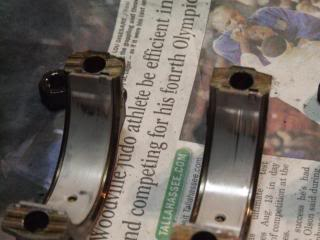

Ok. I pulled the engine back out and here's what I found. I could not tell if all of the caps are in the right spot as they were not marked. It does appear that they were all installed in the right direction. Upon removing the caps and bearings this is what I found:(The crank has only been turned by hand. The engine has not been run yet. Do these pics possibly narrow it down to a specific issue?)
#1 & 2
#3 & 4
#5 & 6
The tangs on the bearings for the caps and rods should always be together on the same side...if that helps. But if you have possibly mixed up the caps and rods, then you have no choice but to start from scratch and have all the rods reconditioned or replaced. There is no way around that. They are a machined set. Next, let's look at what bearings you have there. You are still using a standard sized crank, right? Pull the bearings out of the rods and caps and look at the back of them. See if they say STD, .001, .010, .020, etc. It should be stamped on the back of each and every bearing shell. That sure appears to be undersized bearings for the size of the crank, or that you have rod caps mixed up so the bore diameters in the rod are wrong. If that's the case, then you could have the correct bearings. Regardless, they are shot and you need new ones. This is why it is so very important to check every bore and shaft size if possible. You never know who has stuck what part in a box.

Thank you guys for all the help:notworthy. It turns out I had the caps on backwards. They are stamped and in the right place but I didn't line up the tangs on the bearings. I turned them around and torqed it back down and it all spins fine. I have new bearings to put in tomorrow. I'm sure glad it wasn't worse.
