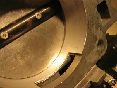

At idle, the throttle plate should be almost completely closed,
that's when the IAC valve kicks in. It allows for a certain amount of metered air to bypass the throttle plate to give you the correct idle speed. If you have a stuck IAC valve or the throttle cable is hanging up or there is something in the throttle body keeping it from closing properly, your idle will be abnormally high
