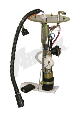

I understand the concept you described but the Ford Wiring Diagrams for my 2000 don't seem to support it. I agree the PCM monitors the TPS but there is no way for the PCM to control the voltage to the fuel pump. The only electrical connection I can find between the PCM and the fuel pump is PCM Pin 40 (Fuel pump relay input). It allows the PCM to monitor the voltage of the path from the fuel pump relay output to the fuel pump via the inertia fuel shutoff. If there is a fuel pressure driver module it would have to be located in the fuel tank and be independent of external control. The photo below of a fuel pump assembly was posted some time ago by ranger7ltr.

3rd Generation with fuel pump driver module
I did a search for "fuel pump driver module" and learned according to the following thread that it was implemented on the 3rd generation models.
Fuel Delivery Issues ***SOLVED***
I'll have to see if I can find one on my Sport but didn't notice one when I dropped the fuel tank. It doesn't show on any of my wiring diagrams.
