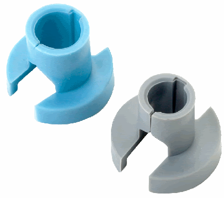

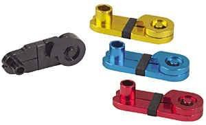

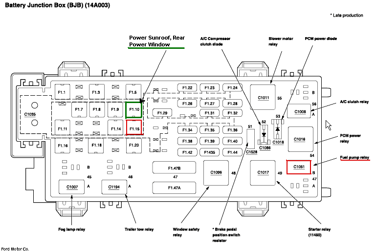

My next door neighbor recently bought a 2004 explorer sport track 4x4 with the 4.0 v6. He called me yesterday and asked if I could do some work for him and I did. I gave it a tune up and an oil change and few other small things. This is the funny part. I was asked to replace the filter because he told me he went on a trip to visit family in mexico and the filter was clogged. Remember this was in mexico. The guy who changed it never depressurized the line and got a burst of gas in his face and he installed a completely different filter. The two hoses on the filter are being held together by wire because I was told they kept popping off. SO I dont know what to do. I need to know what rely unnder the hood is the one for the fuel pump and I never changed a filter that require a disconnect tool. Im stumped. Plus, I dont know if the hoses have stretched out and cause a leak when the new one gets installed due to the wrong filter. I need big time help on this one.
