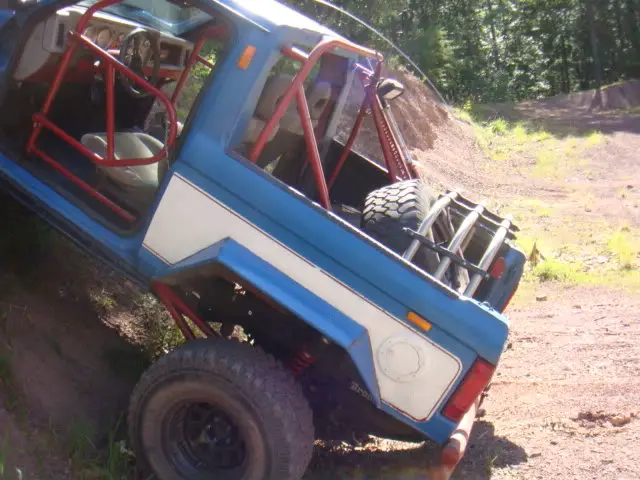

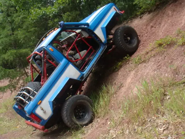

I'm testing by extended wheel base B2 up a kinda steep hill when all of a sudden it comes out of gear and I went flying backwards. After I nearly sh#t myself and got control of it. The tranny kicked back in gear.
So I tried it again and this time my one foot was ready on brake. It did it again. But after those two times it worked fine.
Could a little low on fluid cause this and the level in pan was not adequate for the pick-up?
Will a deeper pan help even though the pick-up is not extended?
Or is this just something an auto C4 does from time to time?
Should I put more then normal amount of fluid in to compensate for the angle of the pan when doing an extreme angle?
This is where it stopped. My gusstement around 40ish degrees.

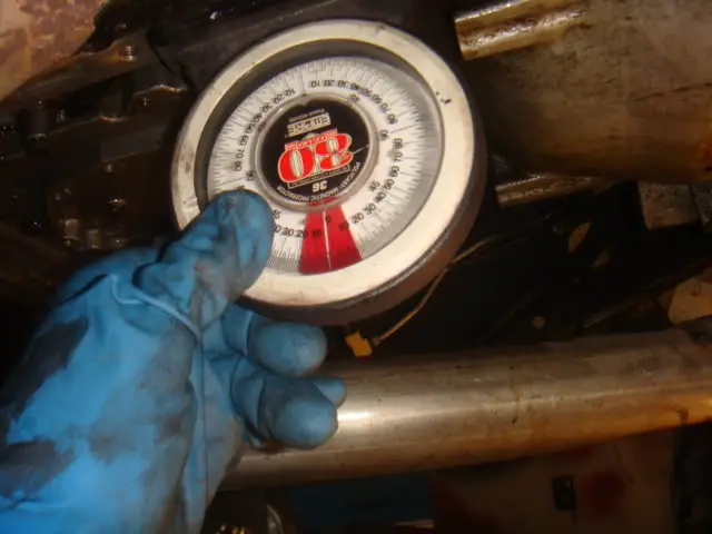

Here are some statistics. The truck is sitting on level ground, I know, that's a miracle in itself in West Virgina.

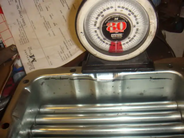

With pan removed the tranny is on a 4 deg incline toward front.
This will show you what 4 deg. looks like when sitting on level ground if the fluid was filled to the left hand side. Black mark is the level fluid with pan at 4 deg.
The bad news the pick-up is on the front end that is on the lower side of level.

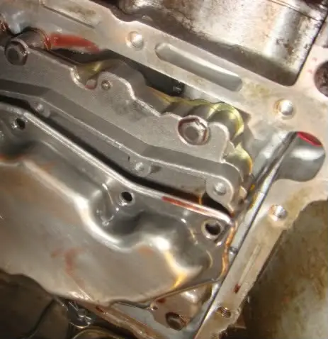

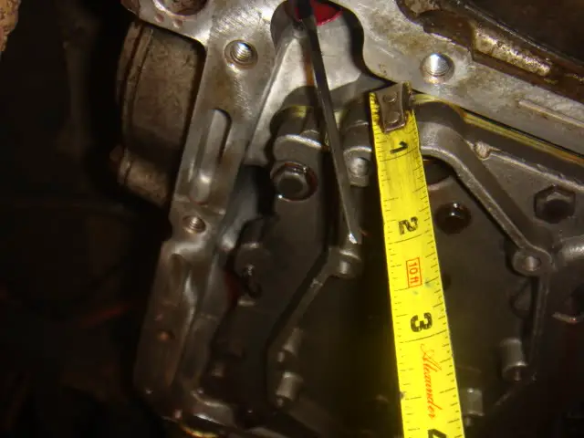

Here you can see the raised inside where the filter bolts to the protruding cast part.
Notice where the fluid enters the housing. Right next to the tape. It is actually flush with the mounting surface that the pan bolts too.
Now here is where it gets interesting.
If I was able to extend the protruding cast another 1/4" down, would this help?
One other thing, where the bottom of the dip stick is at the top of those cooling tubes. And this is an after market pan that I don't know what is the correct amount of fluid it holds.
I'm thinking not, because once the fluid gets below the pick-up hole it would not make a difference how low the screen was even if the extension was air tight. Right,wrong?
Now here is the other question, where should the correct full level be when hot? Level with the mounting surface which is level with the opening in bottom of case, a half inch higher, or what?

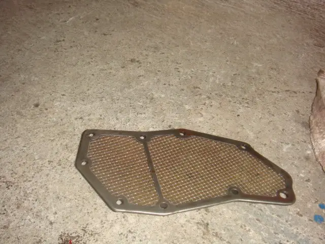

Here is the filter. First pic is the screen part that faces the tranny.
The last clearly shows that he pick-up hole is at the end of the pan where it would be the lowest level and then it would just get worse on assending.

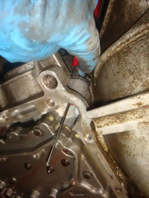

The pick up hole is the large one just to the right and up about an inch from the end of the dip stick. Angle makes it look crescent shape. The front of truck is to the right.
Where my finger is located is where the dip stick tube goes into the case.
What I did was to make a mark on the stick just below where the gasket goes around the tube.
This is about 3/4" higher then the fluid pickup hole.
Where I used to have a full marks was not much higher then the pick up hole in the case. Now I can see why ( I think ) it starved for fluid on up hill accents.
Next will be to go to the exact same climb and test it out :)
