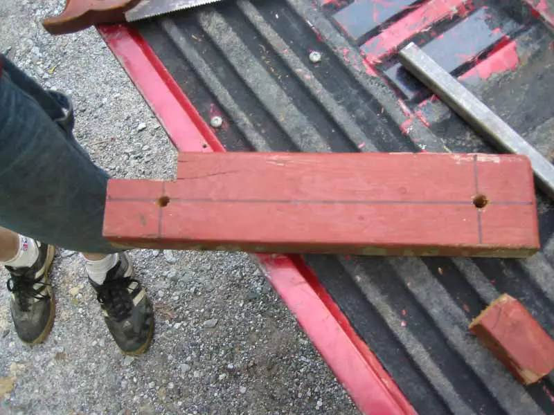

I built a mount for my hi-lift today, it will no longer be banging around in the back of my truck. It was really easy to do. i used a 15" piece of 2x4 and drilled the holes 11" apart. i then used 5" carraige bolts to hold the hi-lift in place. I also had to notch out the 2x4 to fit around a cross member behind the plastic panel. I did however have to remove my stock amp inorder to get the 2x4 in place. anyway here are the pics.
the first one is of the 2x4 i made as a backing plate.
