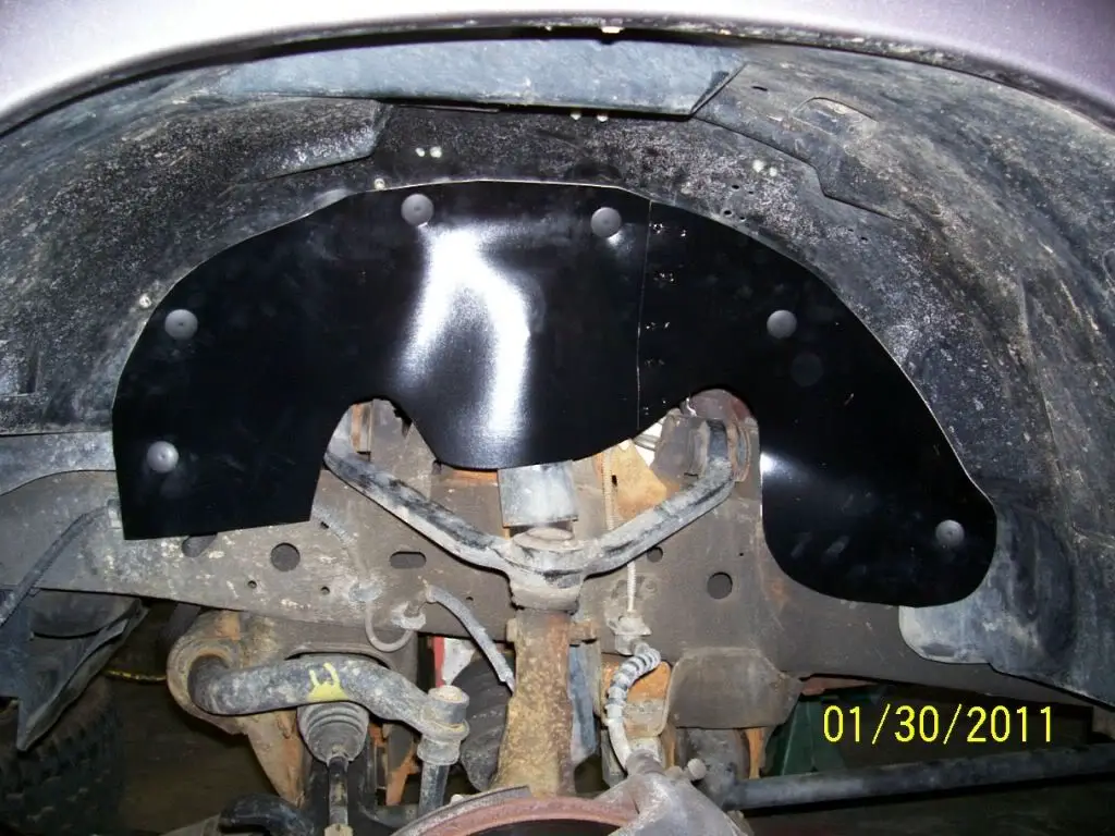

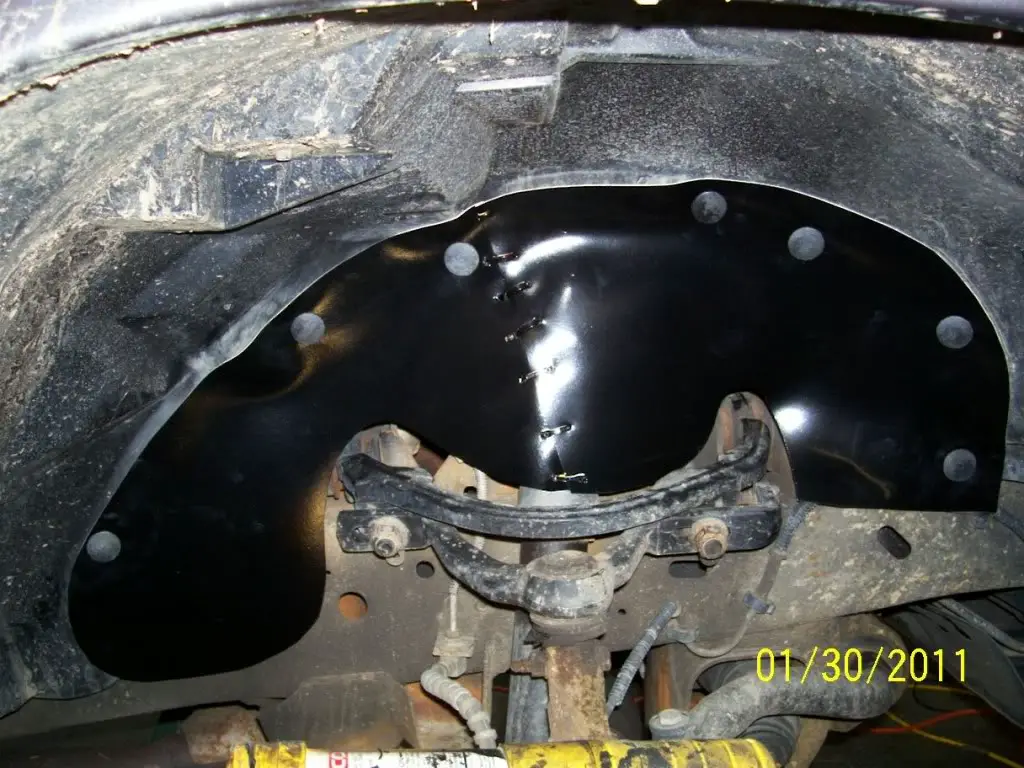

The splashguards that go inside the wheelwells were in bad shape. I was going to wait until I had to do a brake job but figured since I had to remove them now was a good time.
Considering that I blew the engine in my Yugo when I hit that clogged storm sewer a couple of years ago from not running splash shields I figured these were there for a reason.

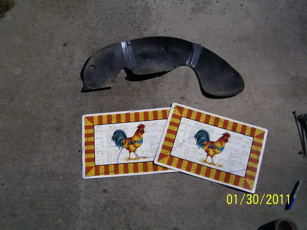

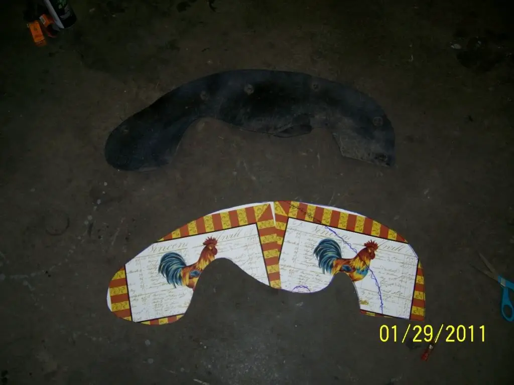

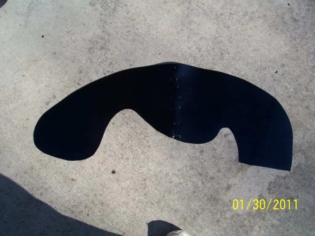

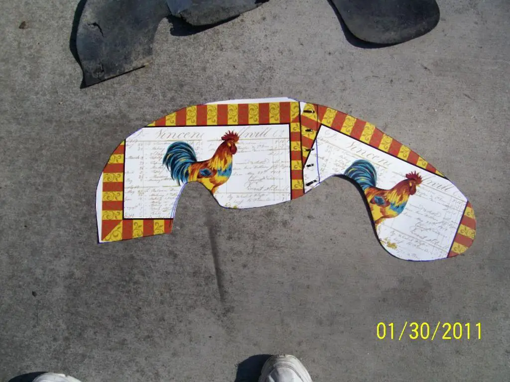

I could not find replacements without going through the dealer so I made my own out of some place mats I got at the DG. The vinyl paint from O'Reillys cost me more than the mats.
If I could have only found bigger ones I wouldn't have had to link they together with zip ties.
thats pretty slick, id have left the roosters, but then again my exp is painted poop brown, with a brush for texture.....
Real nice craftsmanship there! :biggthump
I tore my splash guards off over six months ago. Ever since I've had something like this in mind on the back burner. Congratulations on actually getting it done! I was worried of heat from the exhaust manifolds being too much for a random plastic material. And was going to look for some type of fire retardant material and cut it to fit.
