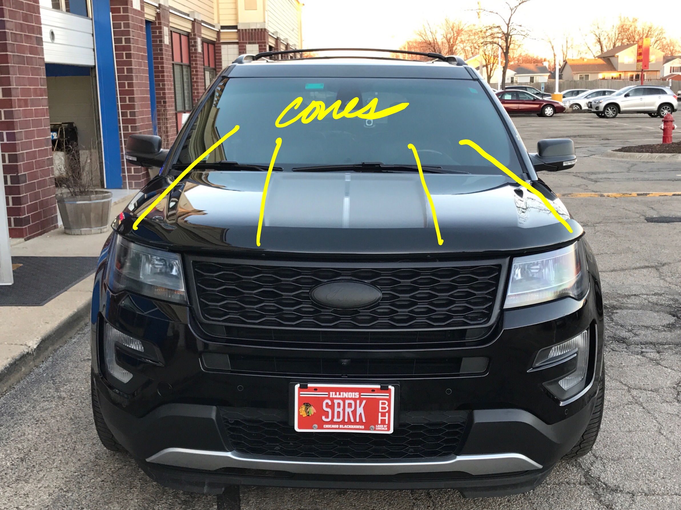

jonnoriega - I just got a 17 Ex base and purchased a OEM Ford hood deflector. I need it to stop raining so I can install it but where did you place the black cones behind yours at? The directions that came with mine don't say where, they're just supplied.
@BradleyFord I had my garage buddies install them and this is where they put the cones. I hope this makes sense?

Are the cones in addition to two sided tape or are they themselves sticky on both sides replacing tape?
For the OEM hood deflector from Ford there is no two sided tape on the deflector, it's secured using 6 clips to the hood. The two in the middle are secured via a screw to an existing hole on the inside of the hood, you pop out the plastic plug and replace it with a clip that goes over the hood and secures into the hole with hardware and screw. The other fasteners don't use a screw, they're just very tight against the hood and clasp the rounded edge. There is 3M clear tap that you put over the hood where the clips go over it to protect it and add some width for the clips to squeeze. As for the cones, they're only sticky on the bottom where they attach to the hood, that is basically double sided 3M tape too, but not as thick as the other ones provided. The only function of the cones are to keep the deflector from being pushed back and making contact with the hood.
