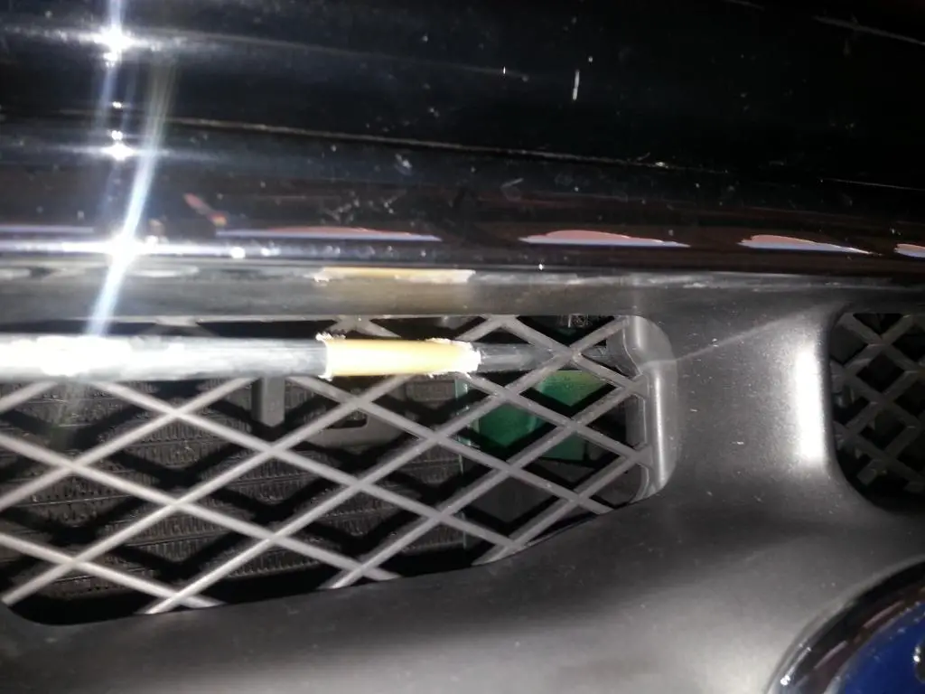

Maybe trough the front grille?
Exactly.....I have to occasionally use a special rod. You can see where to place what ever you use ( screwdriver will work ) in the pic attached. Once you get it positioned gently push to the right but with pressure,
