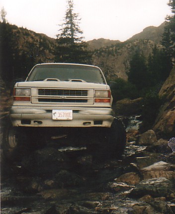

I decided that the KKM was heating up too much for my liking so I purchased a set of black hood scoops.
After looking to paint them on my own I couldn't resist the $80 I paid to have a shop do it all instead of paying nearly $40 for just the paint.
I cut out the holes to make these functional then took to my hood for 4 nice holes, leaving the cross member in place. I then added nine rivets along each side to keep these suckers down.
Here is a couple pics.

that looks really good, do you have any more close up pics of it?
yeah on undeveloped film. I am going to be taking it in soon.
Thanks for the compliments. I did this before Colorado and forgot to post pics. It might be one of my favorite mods so far. Nothing like taking a sawzall into your hood (at the time not sure if they would work.

How do you keep water out? or doesnt that hurt anything?

Hey Danny, did you use any type of screen in the scoops to keep big crap out? Oh and are those the Lund big or medium one's?

danny i take it those are the lund hood scoops? make a differance on the temp? cause mine been heatin up too. LOOKS GOOD!

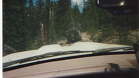

and lastly here is a shot from the drivers seat. Kinda cool
