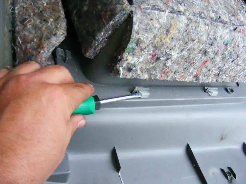

How do I open this:
I need to run my power cable behind this, and I don't want to break it.

I beleive you will have remove the entire panel. Mine came with the factory sub instead of the storage bin and I know the grille can not be removed from the interior panel. I would assume the storage bin is the same way.
Ok, I am a bit new to this vehicle, I have only owned it for about 2 months. How exactly Do I remove the whole panel? Do I pull out the little circle holders?
Remove the plastic trim piece along the back edge of the carpet. Then remove all the push pins or circle holders as you referred to them. You will also need to remove the clothes hanger hook. This should gain you enough access. If not you will also need to remove the upper seat belt bolt (which requires a T45 Torx bit) along with the bottom door sill trim
There may also be a sheet metal screw along the edge of the interior panel around the wheel well.

...or check out starting at picture 4 in my sub thread: CLICK

What insert? There are no screws. (?) If you try to pop it off without opening the retainers from behind, the tabs will break off.
The trim pieace all the way around the cubby pull it off uder this their are screws to remove the little cubby
Show me the screws in this picture. Maybe your first gen is like this but not a second gen.
Or the newer style like the OP has...
There are no screws. The only screws on that entire panel are the 2 that hold the whole trim panel to the floor.
