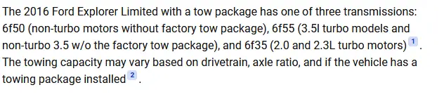

Did an Internet search and found this;

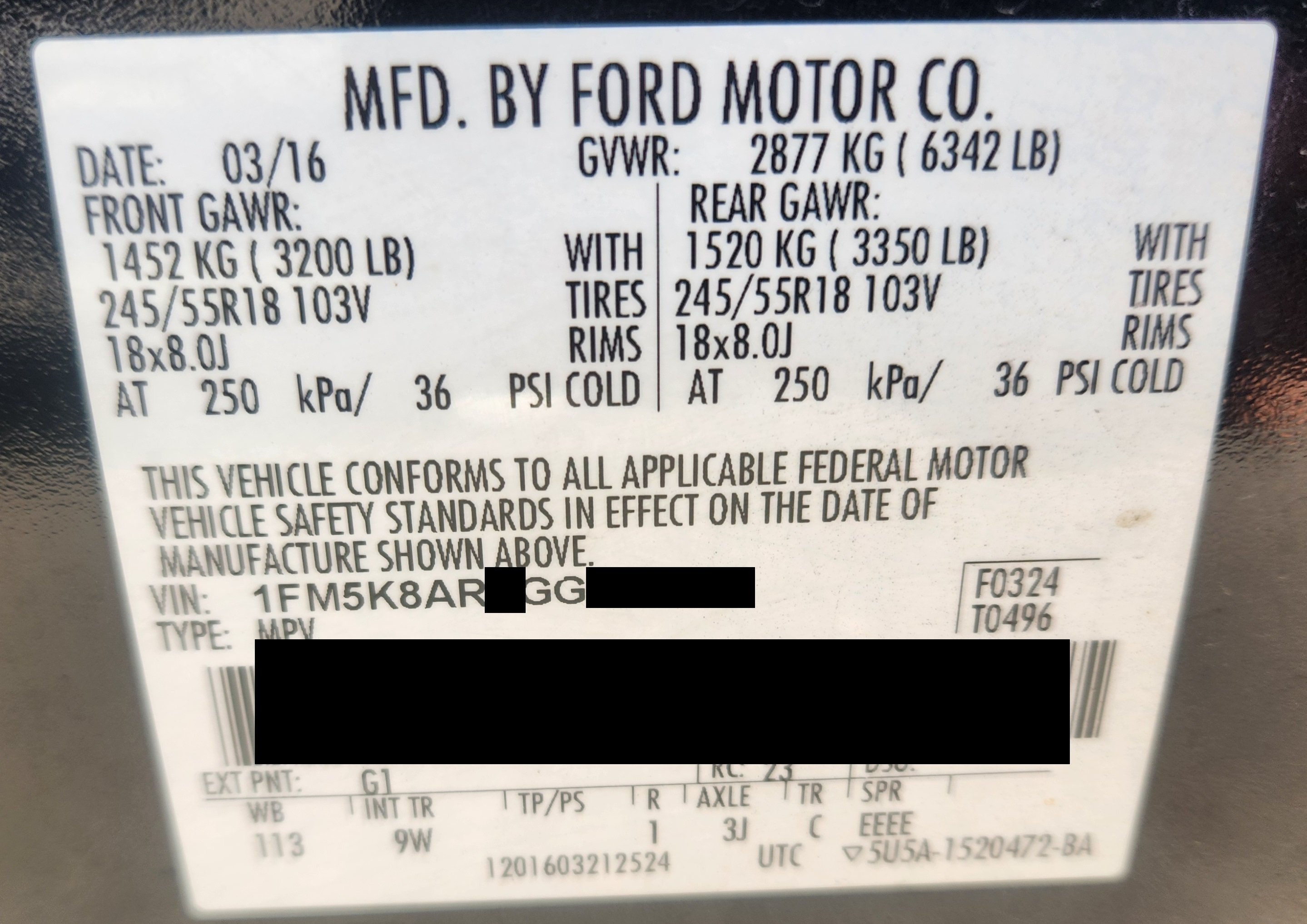

Second - read the labels. Start with the Vehicle Certification (VC) label in the driver's door jamb. Near the bottom, it has a row of codes, including one labelled "TR" or "TRANS" above a single letter or numeral. My signature shows my PIU's details, including the transmission model that corresponds to this code:

There was only one transmission used in this generation Explorer with the V6- the 6F55.
Done.
