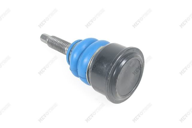

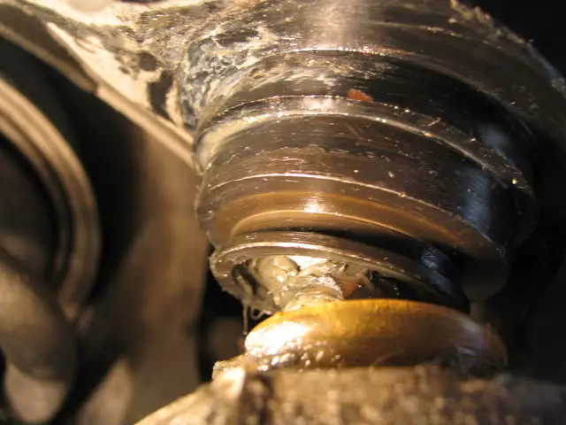

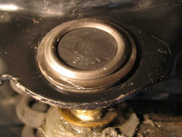

YES, they press out from the bottom up. Put moog K80008's in and press in from the Top down. Apply snap ring and they wont go anywhere.
