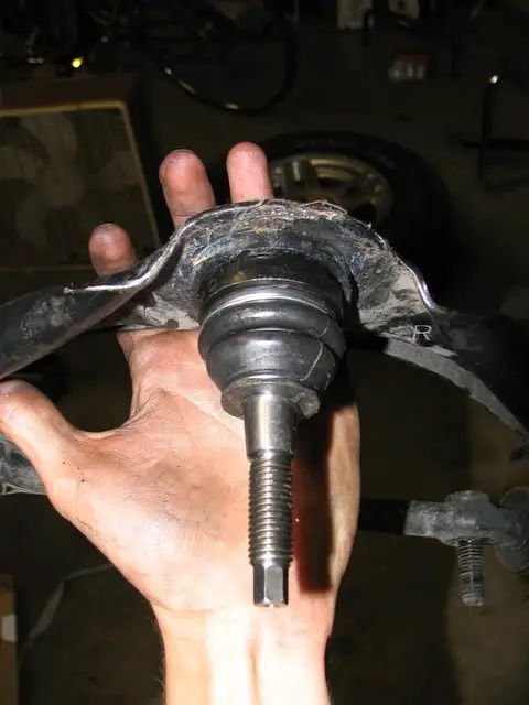

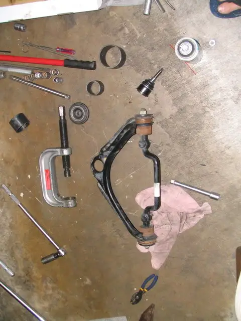

Upper ball joints ARE PRESSABLE!
Here is the proof!
I had to take the control arm out in order to have room to work the press.
The press on the ball joint:
Ball joint removed:
New ball joint:
I'll write a how to later.
I have also replaced my upper ball joints by pressing them. Just make sure when your pressing them back in that they are strait. When i did mine i think one got alittle off and it came back out so i ended up replacing that hole control arm to be on the safe side.

i took the upper control arm off my 03 explorer and took it to a mechanic with a 10 ton press. he was able to remove the balljoint and install a moog one. cost me 20 bucks . no need to replace the upper control arm
