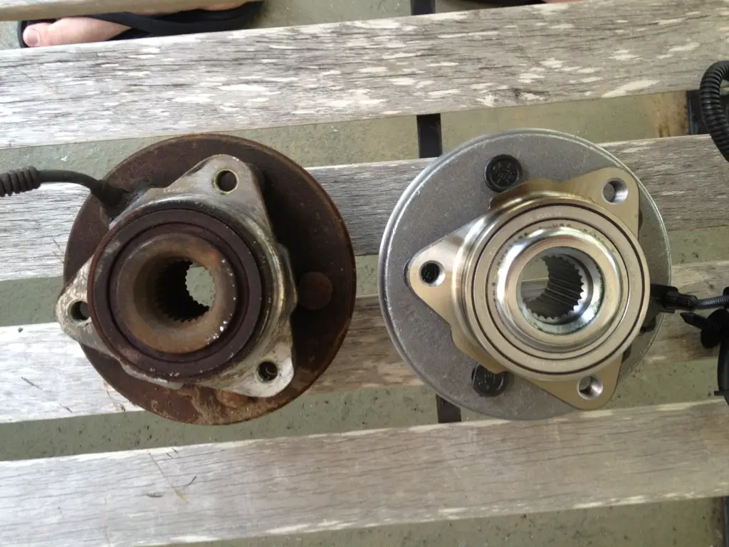

My brakes started chattering and locking up, ABS sensor warning, 4x4 warning, advance trac warning. I'm thinking wth is going on here?
Came to this forum and started my research, the input by users and the technicians here turned out to be a wealth of information. I learned as bearings wear out the sensor gets too close and this is what sends out a faulty reading. Sensors can also go bad, but in my case the sensor was good. NAPA Auto sold me the replacement hub, and with the information here my work was orderly, I had all the right tools, ( including the offset 13mm/15mm I purchased at Sears)
That offset is a must, or those three bolts will drive you crazy. About 2 1/2 hours start to finish, and saved about $350 per wheel.
