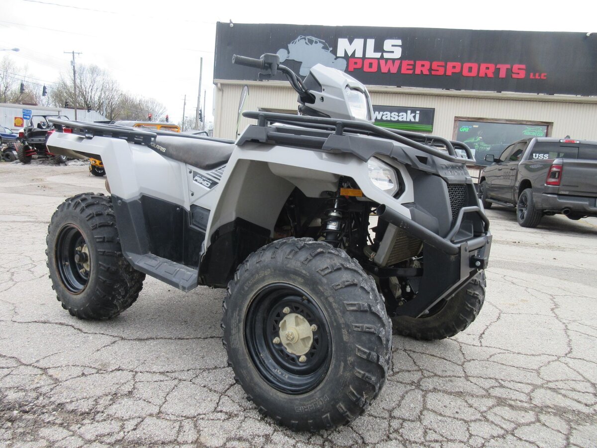

Just a small ATV, I'll grab a photo of it and add it too this reply, I need to get a trailer but I'm not planning on getting anything bigger then a 5x8 for it, Not gonna be towing anything other then this
Most are rated at 3500 and 500 on the tongue
yeah youll be fine. that dont seem heavy in the slightest. shel pull er just fine! however as said if ya plan to tow that regularly i may look into a frame mount depending on hownoften ya tow
Yeah eventually I will I can get the money for one, Thanks for the help!
