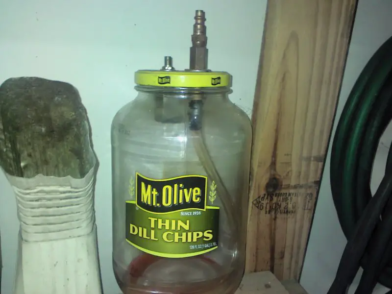

Which is a DAMN good idea if u have 5r55e with NO Dipstick like my 2002 T Bird ~! - Then I use my pressurized Pickle Jar via the "annulus" … what a PITA ~!
