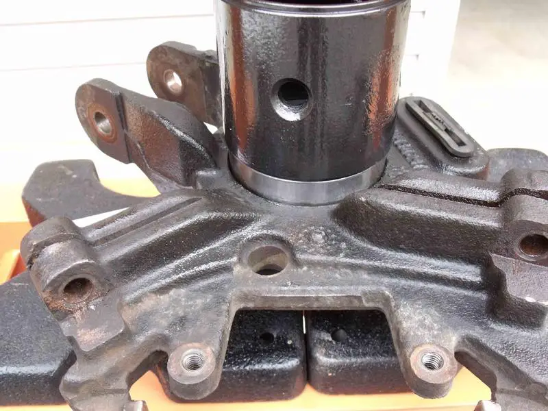

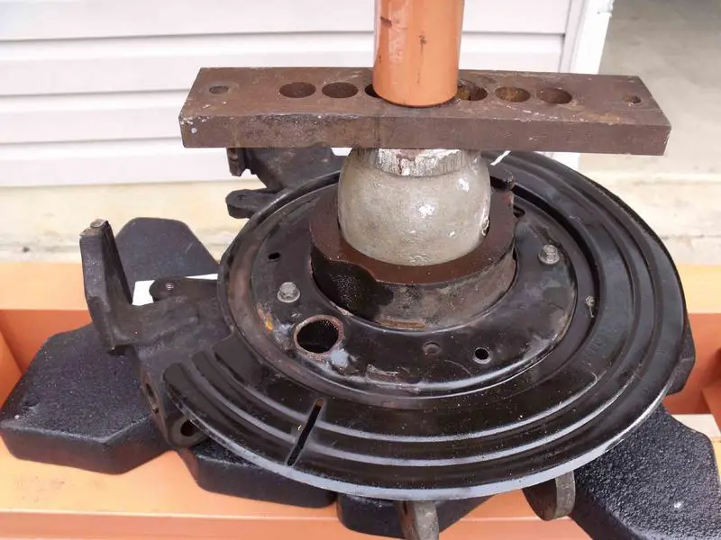

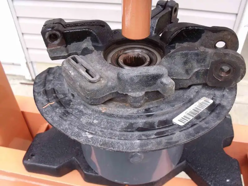

Thursday 7 Feb. I pressed both rear wheel bearings & hubs on my 04EB. Both bearings I removed were ### Brand bearings. The hubs had no markings as to where made or by whom. The bearings were made in Canada.
The right bearing & hub pressed out fairly easy even though it was the one I was concerned about. The left side would have been OK to run awhale longer. I did both because I had the parts and shop time. The bearing was a bear. The hub pressed out hard all the way and the bearing was no better. I had a 30inch pipe slid over the jack handle. As MITCHWSL had noted, he saw some signs of wobbling on one hub. Isaw some early signs of wobble on the left hub. This condition maybe a reason for hard pressing.
The photo of the black sleeve used in pressing the bearing, I had to grind it around the bottom to finish pressing the bearing
