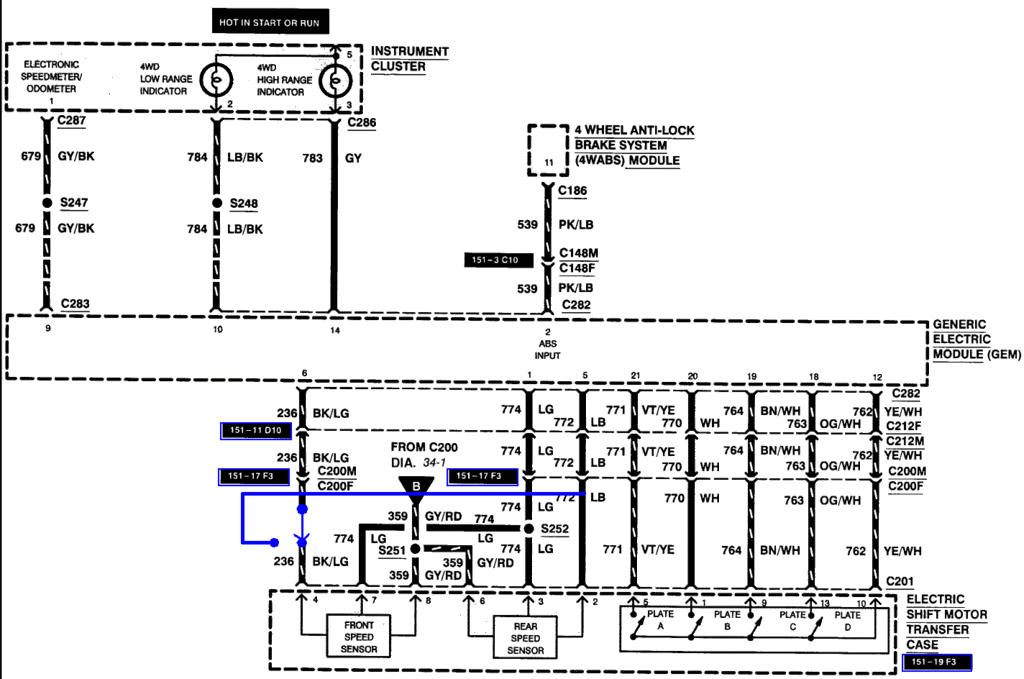

Still, a blinking dash light, for 6 months is not cool. Any ideas on how to prevent the Control Trac from getting upset? How many speed senors in the t-case? 2 (front and rear output shafts?) Are they the same? if so, why not just "spoof" the one for the front shaft, so the computer thinks it's turning the same speed as the rear? If it was setup with a switch or something, you could have the "spoof" active when the front hubs were unlocked, then switch it back to the normal sensors when you want 4x4. In fact, doing that, a brown wire mod wouldn't be needed. If the computer thinks the front/rear are turning exactly the same speed, then no slippage= no attempt to engage the TCC; right?
I suppose you could install a switch that you could leave in a "normal" setting when the front hubs are locked. Then when they are unlocked flip the switch which would disconnect the front sensor and send the rear signal to the front signal wire as well.
This should work. The low side of both sensors are common. Only the high side needs to be "fooled" so to speak. Simple single pole double throw(SPDT) switch. The center pole of the switch is on the front sensor wire to the GEM. One side to front sensor t-case side other side to rear sensor output.

I may have answered my own question. I picked up a Gem module out of a 99 V8 Mounty at my local u-pull-it yard for $15. There are 2 different modules for the later gen II's. The V-6 Control Trac Ex'es use the 4x4 module. It says 4x4 Control trac a4wd on it. The V-8's use the 4x2 module because there is no input from or control of the transfer case since it is AWD and requires no driver or computer input. I replaced my 4x4 module with a 4x2 module from a V-8 Mounty and my blinking lights are no more. Also I haven't experienced any driveability issues either. My PATS seems to be working fine. My same key starts the truck and my THEFT light is normal. I figured for $15 I might as well try it, and I'm happy to report all seems well. I'll keep everyone updated of any problems that may come up, if any.
