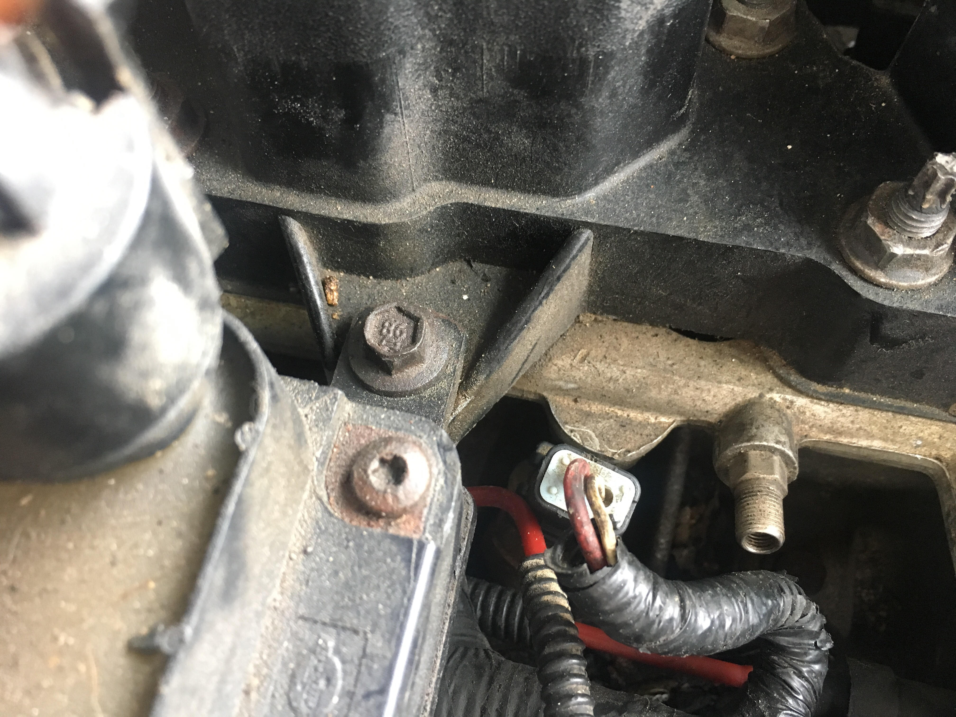

how to perform fuel pressure check?

To check your fuel pressure you need a fuel pressure gauge attached to your fuel rail's Schrader valve (looks like a tire valve). You can borrow a fuel pressure gauge from an auto parts store, or you can sometimes get away with using a $5 dial-type tire pressure gauge. I believe on a '95 you should see around 35-40 PSI.
ha, no cap
Hmmm, you can probably install a tire valve cap over it when your done, but try to clean the valve off before checking the fuel pressure. If there's any dirt in there it could prevent the valve from sealing and then you could end up with a fuel leak. Some brake/parts cleaner (using the plastic straw it comes with) would probably work to flush it out.
don't have brake / parts cleaner at the moment. can i use WD40 to clean it? just spray it?
Not the best choice, but I suppose WD40 would be better than nothing.
sprayed and closed the cap. started the engine and it started, and that was the last for today.
it happens everyday
This got me wondering, if the fuel rail valve starts leaking can it be replaced with the same valve core you'd buy for a bicycle/etc?
While the valve is basically the same design as a tire tube valve (and perhaps even the same size) I imagine the seals in the fuel rail valve are most likely made of a different material to be fuel resistant.
