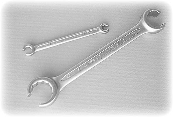

Use a flare wrench.

A line wrench does it 99% of the time. Although it's rusty on the surface, the mating treads are seldom rusted beyond the first half thread or so. The key is to use a line wrench (AKA flare nut wrench) so that it grabs all six faces of the nut, not just two.
