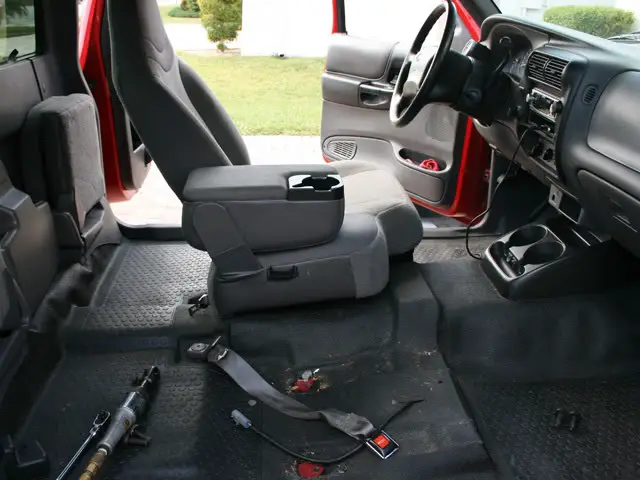

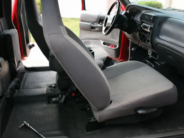

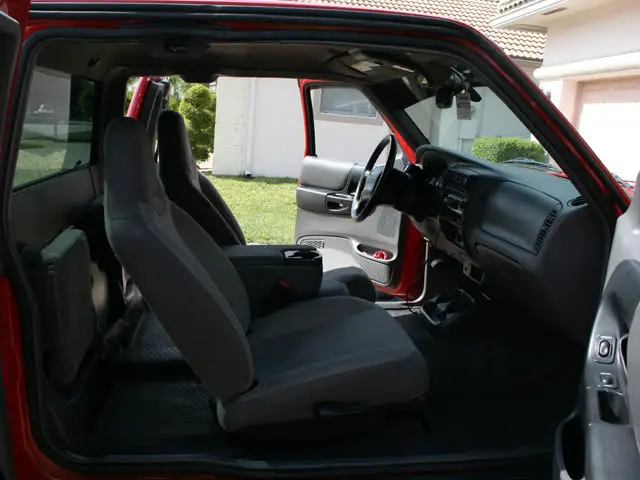

Here is the interior, the front seats as well as most of the trim will have to be removed.
The seats require a T55 Torx to remove.
Slide the seat all the way back and remove the front two bolts.

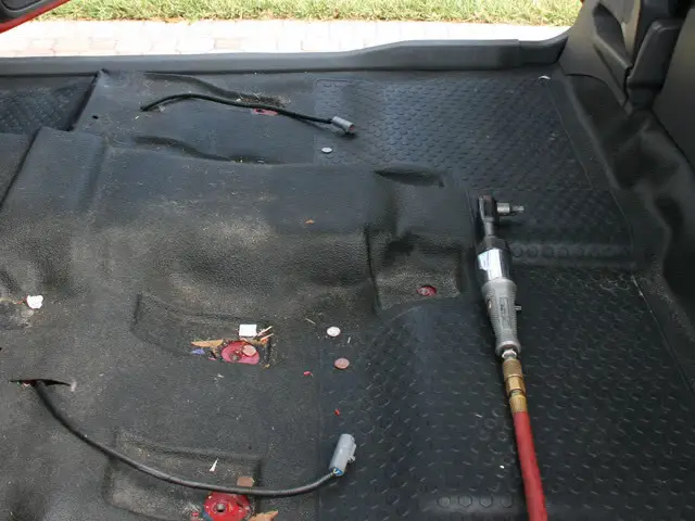

Slide the seat all the way forward, then pull off the two plastic tirm pieces from the tracks and remove the rear two bolts. They are not very tight, but are somewhat long and the threads are pretty fine so they will take a little while to remove by hand. After I removed the first two it took longer then I wanted so as you can see traded the hand wrench for an air tool.
There is a small plug under the seat that will have to be unplugged. After you do this you can pull the seat out.

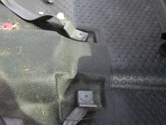

These will also have to come out, they are the seatbelts for the center seat.

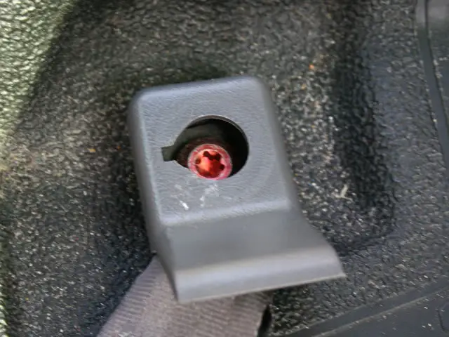

Pop off the covers to reveal another Torx head bolt. These will require a T50.
Remove them.

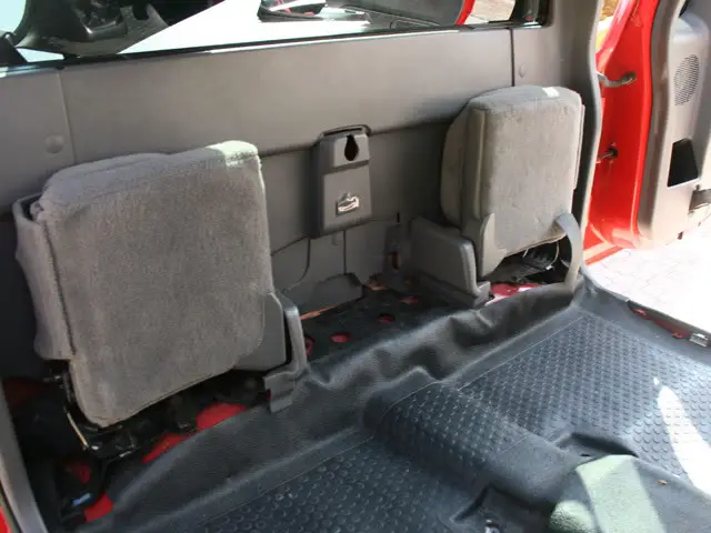

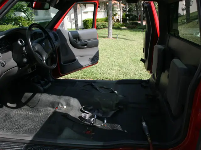

Pull out the old carpet and set it aside, do not cut it up or throw it away just yet.
Now is a good time to vacuum out the floor.

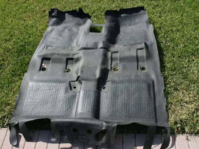

Here is the old flooring, as you can see it has plenty of cutouts unlike the new carpet.
You will need to take the old flooring and place it on top of the new carpet and then trace the edges and holes after lining it all up. Use regular white chalk to trace with. You can see I did not trace the cutouts for the drivers side rear seat, that is because I am removing it from the truck. DO NOT CUT ANYTHING YET!

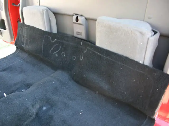

You will have to do a lot of trimming on the rear, take you time and remember you can always remove carpet if it is still too long.

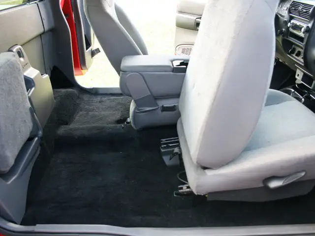

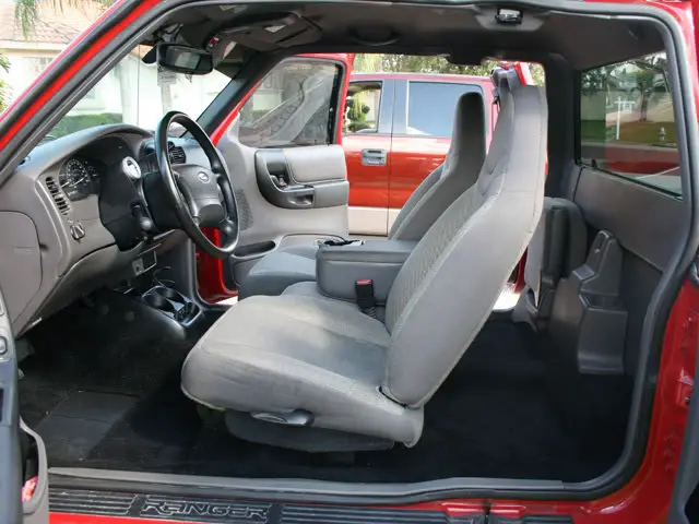

Here is how it looks all put back together. OEM quality without a doubt.
