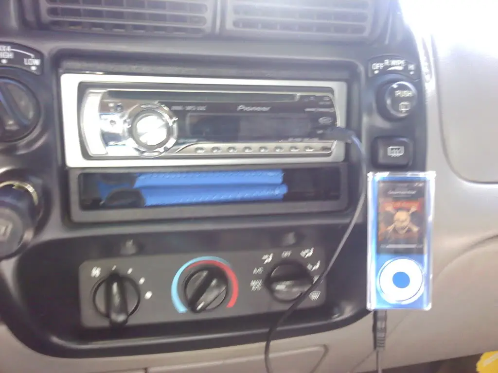

97_Explorer_XLT
- June 9, 2010
- 36
- Minnesota
- 97 XLT
My get up, a little velcro on the dash and some on the back of the Nanos clear case and my Ipod stays put.
97_Explorer_XLT
- June 9, 2010
- 36
- Minnesota
- 97 XLT
Damn I didn't realize that pic was that big
