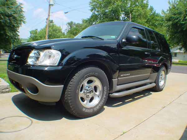

I want to do your mod. Just tell me how the ride was after you finished. Does it feel safe? I know you needed an alignment too right? Was the ride improved? Let me know thanks I have a Black 01 Explorer Sport also.
ExSporton20s The ride is great! I really like the way it rides now. Very much sportier! very sticky to the road. I have Saleen Sway Bars as well to help the ride. I am wanting to get new shocks after I get the Rims on.

InS0mNiAc You should have no problem what so ever. This was my first Suspension mod ever as well. Nothing is harder than turning a bolt. All you do is lower the front with the T-Bars and the rear by unbolting the rear U-bolts and putting in blocks and then rebolting.
I have faith in you that you can do it!

I haven't taken the bolts all the way out. I have heard of others doing that. But the problem is you can run into is leveling the truck from side to side.
Others have flipped the t-bars to achieve a lower stance. There are threads on that around too.

I have a 5" drop and I'm barely tucking rubber on my 18's. And anything more than 2.75", and you should C-notch the rear.

I'm new to the forum, just wanted to let you know your ride is the reason I joined. It is sporty and tight. Thanks for posting pics and your step by step mods.
scholar_g
Looks good. I've been wanting to lower my Sport about 1" but haven't gotten around to it yet. Since you're almost on the bump stop do you have a problem of bottoming out over bumps?
