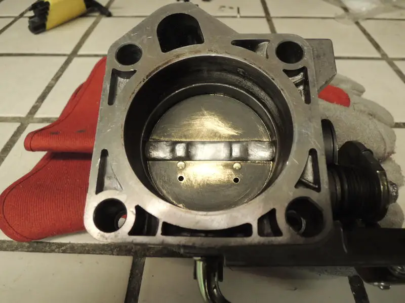

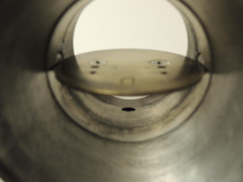

So after reading this thread it got me wanting to mess around with the extra TB I have. Its off a 95 the only difference I can see is the 91 has 1 single hole in the throttle plate. The 95 has 2 but there smaller holes. The throttle linkage looks almost the same slightly different but I think it will still work. So anyways not going to show all my steps but just show you my finished modification. I think most of the gain could be had in narrowing the plate cross bar. Widening the bore bigger really doesn't help much unless you can make the throttle plate bigger. Cause air still has to pass through what ever the size of the throttle plate is which I measure to be about 60mm. So opening up the body to 65-66 does nothing if the air still has to pass through 60mm opening. I went and googled Modify throttle body to see what people have done to them. I saw where some just thinned down that cross bar. Saw one where they took a section out between the two screws. Then I saw where they completely eliminated one side of the bar and thinned down the other side. I liked this idea.I didn't touch the bore at all I might smooth out the small ledge you see. If I do try to widen the bore I'd look for a bigger throttle plate off some other TB to fit into mine.
