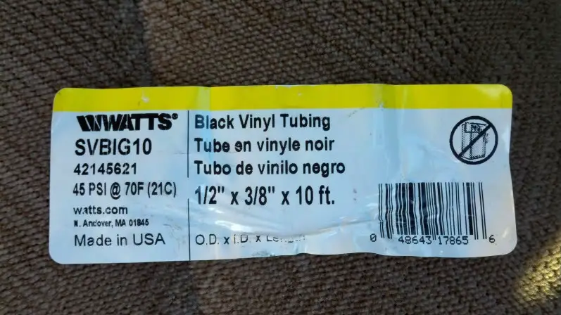

- Some form of 1/2" x 3/8" rubber hose or tubing
Here is what I got from Home Depot ($3.37 with tax):
Loosen the striker bolt and unscrew it from the vehicle with the star socket and socket wrench. It may be on there really tight from age. I had to use a medium-large sized socket wrench to get my passenger side off.
Once you have it off, use the bolt or the old bushing as a size reference for the new one you're going to make. Cut a piece of the tubing to fit. You can heat the cut piece with a lighter to make it more flexible. Don't heat it too much, the rubber will melt and lose integrity.

It should last for a while. Maybe not as long as stock, but it is rubber and not hard plastic. The flexibility of the rubber should make it able to withstand more hits, at least I think. I will let you know how it wears.
Yeah, that is my thinking. The vinyl is not as durable as the factory material. And the above poster comment about Pex makes sense to me. Anything is worth a try if your door is loose. Please let us know how it works.
I couldn't find the PEX. Is it in the irrigation aisle in Home Depot? What is it used for (where would I find it)?
PEX is used for plumbing (water supply), so you are getting close.
