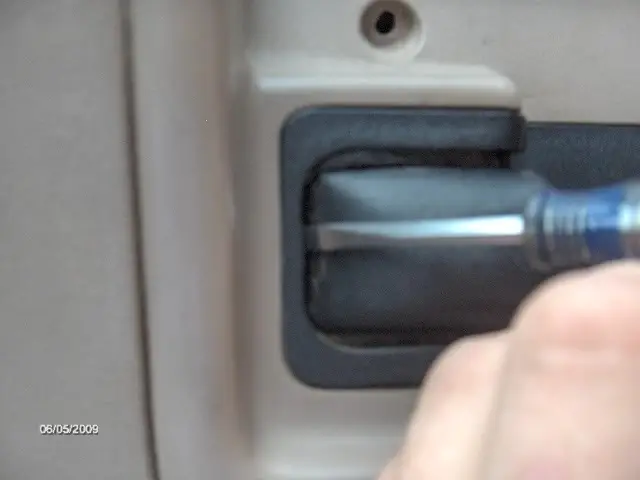

4) OK enough humor, lets get down to buisiness. Remove the two screws that are directly behind the "invisble" handle.

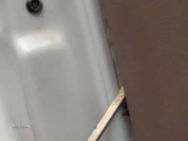

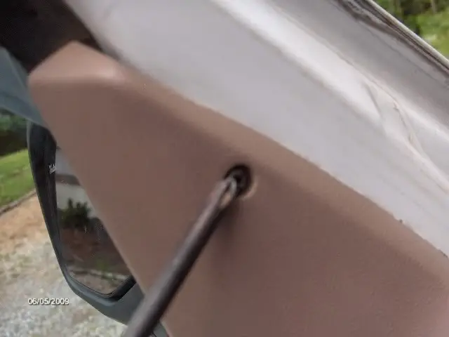

6) Now pop the small black plastic piece off from behind the handle.
7) After that you can remove the panel from the door. Note: you can buy the small tool for this for around $5 or do like me "el cheapo" and use a large flat blade screwdriver.

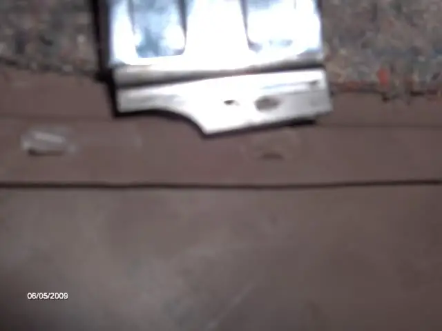

8) OK here's where I got slightly frustrated and forgot to take pics but there's a few wireing hookups on the back side of the panel. You want to remove these one of which goes to the master window control that is attatched with 2 phillips screwdrivers.
9) Now pop this little piece off
10) Alright you should have the panel completely off by now. If not then my directions weren't clear enough and you'll have to get creative. For the rest of the class that followed instruction, we can move on.

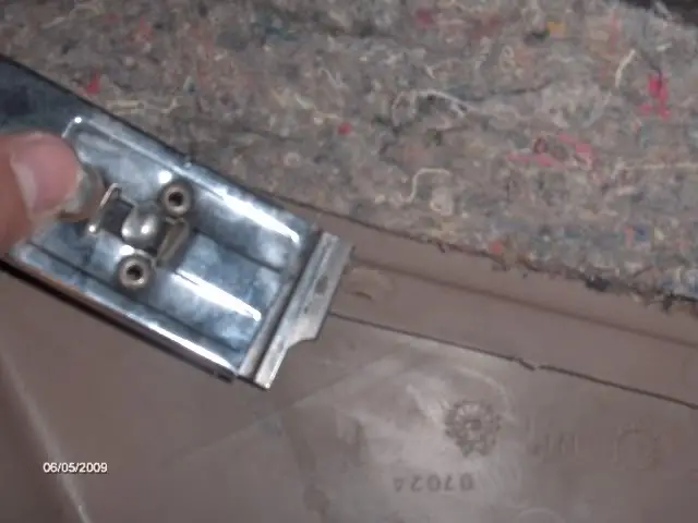

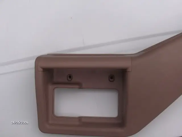

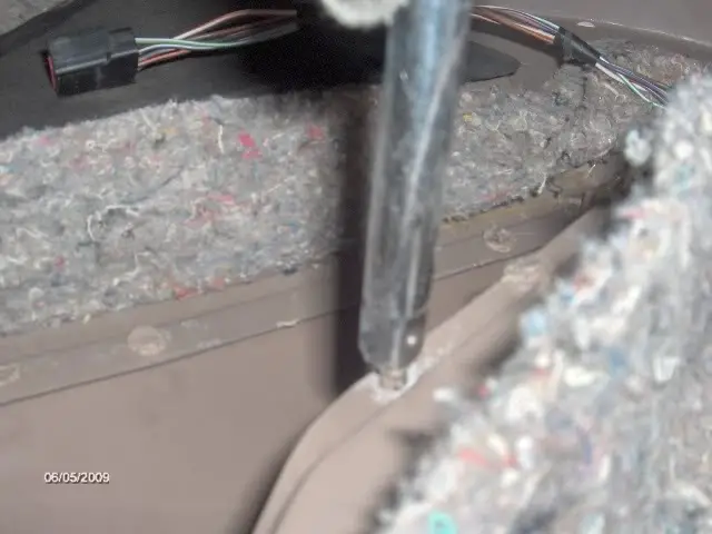

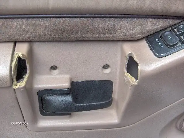

11) OK so here's the next part where I got frusterated but I remembered the camera lol. I didn't realize the small plastic studs on the back of the handle assembly where suppose to be melted. So I started removing them with a window scraper.

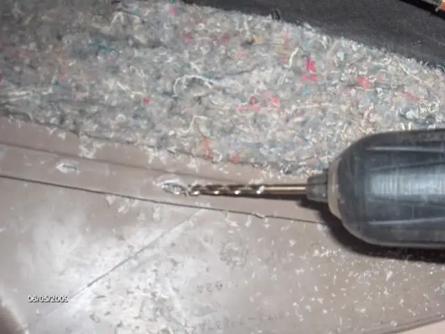

12) After breaking 2 blades I decided I needed a different tool so looking around for the non-existint dremel, I found a drill and a sharp bit. Angleing the drill and lightly "carving" away at the previously melted plastic I was able to remove the old handle assembly.

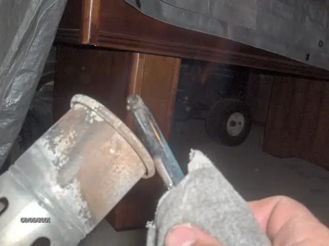

13) Alright now you should have the old handle assembly off and the new one in place but the studs still need melting and guess what? You don't have a plastic stud melter and don't feel like driving 20 miles to the nearest hardware store that may or may not have one then end up driving all over town looking for one. So what do you do? Well here's what I did. I have a torch that's made for burning weeds and melting ice. I set it so that it would stay put while lit and not catch anything on fire then took one of my cheapo 6" socket extentions that I never use, held it with a thick rag, heated the end real well (doesn't have to be red hot, that would take too long) proceed to melt the ends like so.
