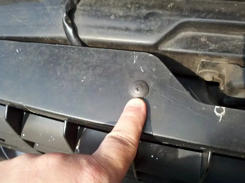

Look for these nylon screw-type attachments:
They sorta unscrew. What I wind up doing is taking a small flat screwdriver, and gently pushing it between the screw head, and the screw, and while prying up, start unscrewing it. Resist the urge to just yank them (but if you do, Auto Zone sells replacements.)
When you get them loose, gently rock your grille forward, up and out.

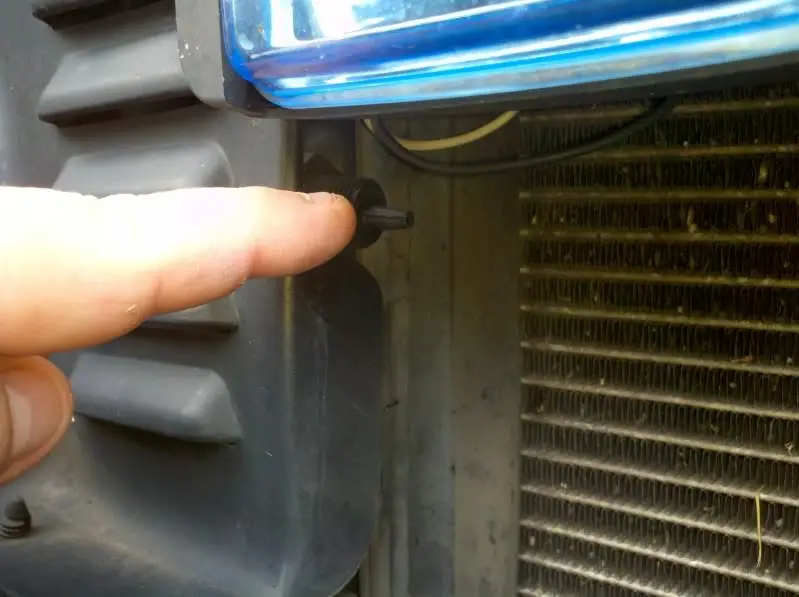

Look to the left of the radiator. You should see the sensor:
poking out.
Notice the plug-type doololly holding the skirt in place? (it's not in the picture, but it is above and to the left of the louvers.
I just take pliers and pull those loose (they also are replaceable).
Now, for some reason, I deleted this picture. You woulda saw the sensor stuck to the metal crossmember by a little attachment piece, that I also yanked free.
Using the small screwdriver again, gently bend the ears of the plug and pull it loose. Put some silicone grease (not caulk) in the socket, if it doesn't need cleaning. Push the new sensor on, push it back onto the bulkhead, and button everything up!
