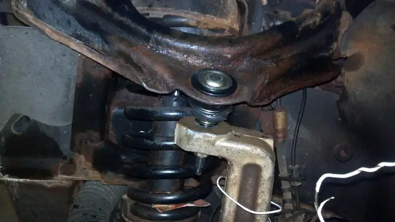

Are the upper ball joints pressed up or down out of the control arm. Mine aren't budging in either direction. I'm using a breaker bar with a socket and I get so far and it wont turn anymore. I am also attempting to press it out without removing the control arm. I had to cut the stud of the ball joint to get the press to fit in due to lack of room above the control arm. I really don't want to spend the extra money on control arms. Please help!

This press setup is what I tried when I was attempting to press the old one out. When it wasn't moving, I thought maybe I was trying to press it back in more instead of out. :)
After sleeping on it, and calming down a bit, I realized that it can be done without removing the control arm.
Tip: I removed the spinning shaft and ball bearing from the press. At one point I dropped the press and they fell out. Later on I thought of trying to remove it so the stud of the bj would fit inside it.
I will give it another go this evening using this setup again, possibly with a torch and banging the crap out of it. Hope I don't destroy the control arm. There is an excess of corrosion and rust on it.

Just got the first one off. Apparently having the pb blaster soak in overnight helped. It came off a lot easier than last night.
One side done without having to remove uca.

Both upper ball joints are done. Separating the ball joint from the knuckle on the passenger side was a little bit harder so I used a torch to heat the connection, which made me extremely nervous. But it definitely helped. Pressing the ball joint out and in was a breeze compared to the driver's side.
The trick with the press is to pull out the shaft from the inside of the threads and then the ball bearing. Then the ball joint stud will fit inside the threads giving you the clearance you need to press it out without removing the uca from the vehicle. I then used the medium ring and one of the flat pieces from the press on the top. Then turned it till it popped out. The passenger side ended up pushing the inside of the bj through the housing through the top. I was then able to put the other flat piece from the press on the bottom to continue pressing the old bj out.
Cleaned up the hole on the uca and lubed it and pressed the new one in.
To get the bj nut started I jacked up the knuckle while guiding the stud through the hole and pushing down to start the nut.
