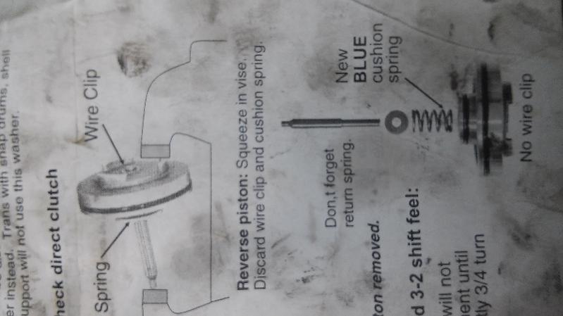

Acording to this i am supposed to remove the clip, yes?

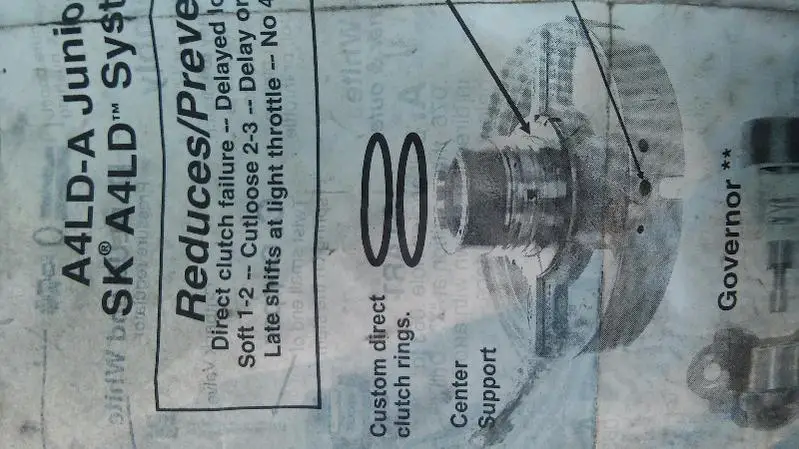

And i have these orings but i honestly have no.clue what this part is.
Those rings are for the center support which is in the middle of the transmission. You can't reach it from the valve body. You have to dig into the clutch pack section (planetary gears, clutch packs, pump, one way sprag, etc) to get to it.
You don't have to remove this clip, but if you do, they recommend replacing it.
