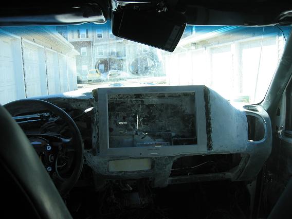

here is a picture of my overhead console right now just for a really unrelated example of what it might look like or something.

wow that looks like that ergonomically blows lol, nice fab work though.

And I'll give you one more holy **** on that dash expo! wow
i need to snap a new picture now. it no longer looks like hell.
How do you put a cd in that one?
