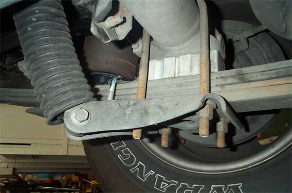

We have been known to use the Monroe Load Leveling Shocks for lowered Explorers with this same problem. This solves the bottoming out problems for lowered Explorers that carry cargo or passengers. These are coil-over shocks that will give the rear an aprox .5 to .75 raise in ride heght.
Another option is to take the 3" lowering blocks and have them milled (shaved). We carry the 3" blocks custom made for us by Chasis Tech. These are made specificaly for the Explorer/Sport Trac rear suspension.
Yet another option is to install the Air Lift system. We have done this before for owners that carry a load or wish to tow with their lowered Explorer. This allows you to adjust the ride height by way of air bags.
