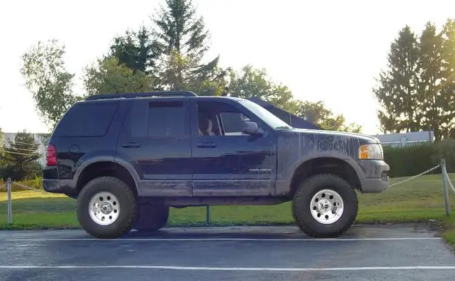

Just for reference this is about what were talking about:
(photochop by dmasini)
I took a drive out to Whaley Enterprises in PA this morning to have him look at the truck. Said its more than doable, but were limited to what we can do to clear the rear frame. At an earley estimate were looking at about 10 inches over stock heigh when riding on 33s. Might be able to go lower, but cant really tell without taking parts off the truck. Looks like wagoneer axles are gonna be a good cannidate too.

I think you guys may have your calculations off... i dont think you'll need anywere near 10" of lift to clear 33's. There is a pic floating around the net of a new X with nothing more than a 3" bodylift and 33's and it looks just right.

jamest, the 10 inches is a guestimite ow what it'll need to clear the rear frame and still have atleast 4 inches up travel. This can change if the frame can be modified to alow clearence for the axle's up travel. the guestimite of 10 inches comes from measurements taken from the rear diff, wich means about 8 over stock due to the angle of the suspention at ride height.
Ideally id like to see between 4 and 6, but like i said im limited by how we can modify the rear frame

Oh, and 33s are planed as i know theyll fit in the wheel openings
Just for curiousity sake how do you know they'll fit? I ask because if you take a 33 tire and hold it up agains the wheel wheels and it may fit just fine... But you may not be able to turn the wheels as they may contact the fender etc..
Because BenS is runing worn 285s on 2nd gen wheels on a stock 3rd gen. I mean i could be wrong, but im asuming with the lift a non worn pair would fit.
I have the pic saved here somewhere, but cant remember what thread its in.
