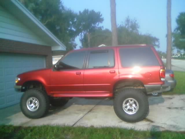

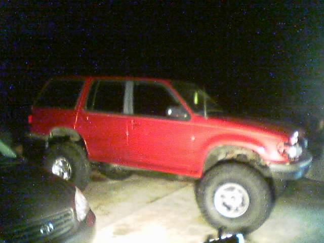

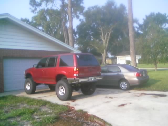

well its on all 4, still lots of work to do, mainly welding on rear Spring perches and re attaching all the rear end stuff, i need to also try and find some camber adjusters(hopefully napa has them) and get it alingned..

stupid camera phones.
good lord man, that camber your ready for the baja, what about taking out the adjustment shims that are prolly between one of the arms and the frame
still a small truck though ;)

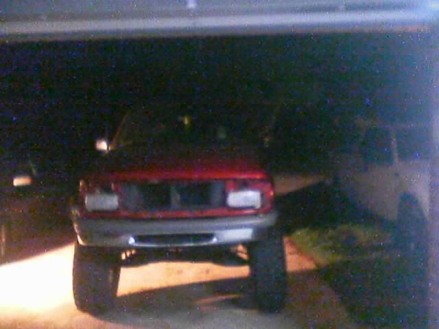

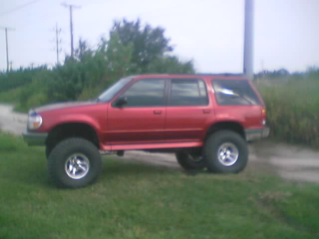

Heres day time pics, still got lots to do today. Plus i think im gunna lift it another 2 -3" but if i do that, ill need to extend my D-shaft, so im gunna see if i cant find a spacer, or see how much it will cost to extend..

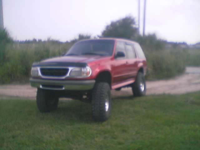

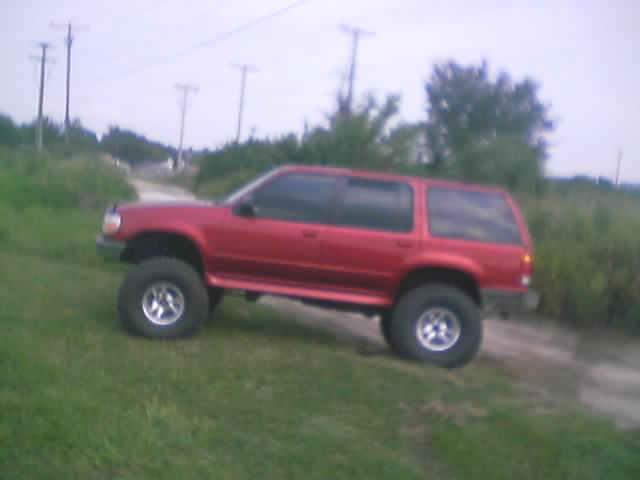

Now its mostly done...
Still some little stuff to take care of..

now I feel short. How much rubbing? I have NONE with my 35's on 15x10s. How is the flex with those tires in the rear?

ok now after examining the pics you need the trailmaster 4'' lift kit still so you can have some clearance
yeah you need perrys

is it me, or is there something a medium blue behind those wheels in the last few pics

after some very MINOR trimming, i have none at normal driving, now if i was to hit a pot hole or flex it at the right angle it would rub, the trimming is only in the front and not even noticable, Ill find my digi cam tonight and get some si quality pics along with some of the trimming.
Hows the flex in the rear? well right now it sucks, i will not stuff without major trimming, since this is a street queen, i dont want to cut, and really dont need to.
Im thinking of going up another 2" Longer T-bolts and either shackles or AALs in the rear.
